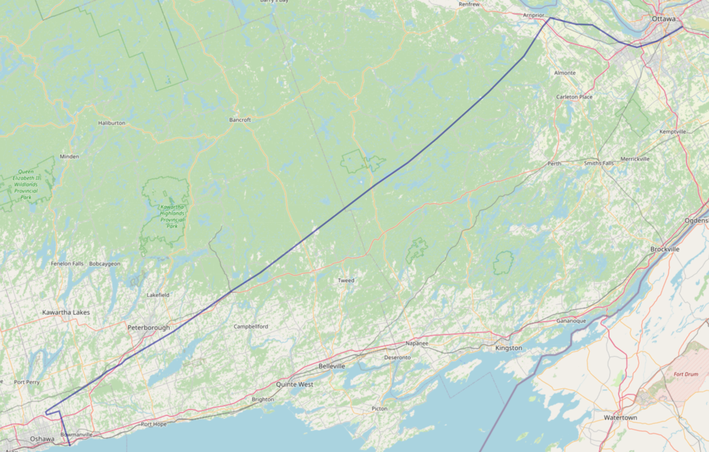

That's what I'm thinking they'll do. The original ROW, aside from being built over in the villages, is also way too curvy for 300km/h service - they'd have to do much straightening of it that it's basically building a new corridor anyway.
There's a hydro corridor that goes from Ottawa to the Darlington nuclear plant. You could basically build the train underneath it. It's almost a perfectly straight line in the rural bits:
You're not serving Fallowfield with that route, but you could have a station in Kanata. That's probably a more attractive suburban station location anyway.
It looks to me like restoring the old line down to Peterborough would still be much less expensive, even if significant straitening of the route is required.
The old line runs through an area that's relatively flat and easily accessible during construction - unlike the power line corridor - which is much more hilly and remote, and also crosses many wetlands. They'd either have to divert it as much as the southern route, or build a huge number of embankments and bridges. Either way - it seems like it's going to cheaper and easier to stick to the old line.
Because of this - expect the Smiths Falls to Peterborough segment to be the slowest segment of the line, no matter how they approach it.
That's the problem. It has to be the fastest, otherwise the plan doesn't work.
As for accessibility of the route for construction - if they were able to get in there to build the hydro line, they can get in there to put tracks down.

We are not building a rail line that maximizes the distance through shield country. We can't follow a hydro corridor without tunneling through Precambrian rock, likely at many locations.
That hydro corridor is much better suited than you'd think. I've actually hiked along part of it before. There's a huge strip of land (easily 100m-200m) that is cleared of trees, largely drained of swamps, and much of the grade has been softened with embankments to accommodate the service road underneath it. The course through Addington & Frontenac counties passes mostly on a high ridge (= easy grading). And of course, it's already owned by the province.
If one is building 300-320 km/h HSR level service, it would be easier to build that route than try to straighten the old Havelock corridor to meet HSR standards, where you'd be truly starting from scratch, more or less. The need to be very straight is one of the biggest things that drives up HSR costs, and this route already has that for some 200km.
You have Kingston bus on your profile pic. Why do you want to bypass it?
As much as I would like HSR to Kingston, the northern route makes more sense for an Ottawa-Toronto HSR corridor. Kingston isn't that big of a city and there's a lot of extra kilometres associated with the Lakeshore route.
Improved regional rail service throughout Southern Ontario, forming a network that connects the smaller cities to Toronto & Ottawa and to each other, is a better solution for Kingston. The eventual goal should be something like the UK's Intercity 125 system.
Hydro corridors aren't necessarily on land owned by the province, they just have a right of way to run transmission lines through them.
This one already is mostly provincially owned, although it is leased in the agricultural areas closer to the cities.

[B]City of Ottawa must prepare for high-speed rail
Where should the station go? Neither the NCC nor Ottawa City Hall has plans for where to put a high-speed rail hub.
My version of that fantasy :
