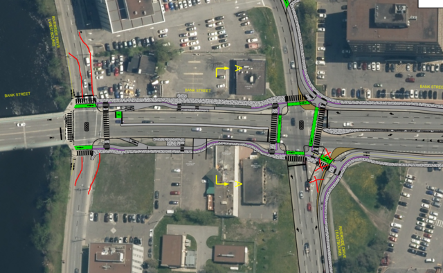

This is not the utopia we were promised back then. I thought the road was supposed to go on a diet down this stretch?
Looks like regular old northern-ontario Stroad Bank street but with bike lanes?
The more I look at the intersection of Riverside and Bank the more angry I get that we can't move the south(west)bound lanes to the north(east)bound lanes, decongesting the foot of the bridge, and removing all those dastardly ramps.
Here's a bang-up job of my 'redesign'. Yes I know its complex because of expropriations necessary. But that doesn't mean it's not worth it.

I would take two smaller intersections over a massive combined intersection any day.
The intersection directly off of the bridge really needs improvement, but combining into a super intersection isn't going to make it safer.
I would shift the bridge intersection south to allow more room to work with making it a proper protected intersection (ideally smoother then my drawing). as well as getting rid of the slip lane that made it into the last round of design.
Of course if I had my way I would definetly not have it be 4 lanes through here anymore, but thats pretty unlikely.
Something to note for this project, it almost went to construction but they went into redesign again to conform more to the protected intersection design guide that was released about a year and a half ago, so we should see improvements when the new designs are out end of this month.

Referring to this design: https://documents.ottawa.ca/sites/documents/files/CP308_March2023_Drawing01_en.pdf
Seems that there are only two ways to go here — your way (collapse both directions of Riverside onto the current EB RoW) or the status quo (which is what the City proposes, with the addition of bike lanes and “smart channels”). Grade separation is impossible due to flood risk, and in any case the City is trying to put this junction on a diet, not add capacity as I was suggesting for Eagleson/417 and March/Teron.
Your design is limited by how many bidirectional lanes you can cram in between the property at 1355 Bank and the historic building at 1346. The treed lot at 1352 (City-owned?) and a partial expropriation at 1355 could make way for a big roundabout — was that your thinking? The plans for 1335–1339 (https://heronpark.ca/2020/09/26/1335-1339-bank-street-development/) also have to be taken into account; maintaining the circulatory roadway around those buildings (and the Pebb Building) is probably essential.
My best idea, then, is to move the WB roadway south (as you suggested), converting today’s WB RoW to cycle tracks and a nice wide riverside pathway, retain the two “Michigan left” loops as clockwise circulatories to serve the properties between Riverside and the river, and grab some land around the unified intersection for either a roundabout or extra traffic lanes.

I'm wondering if a better option would be to:
  • trench the south-eastern branch of Riverside South for bi-directional, through, motor vehicle traffic,
  • Have 2 surface lanes for turning traffic above the trench, and
  • Convert the north-western branch to a cycle track, separating cyclists from the pedestrians on the existing MUP.
The dedicated cycle track should be extended in both directions from at least Herron to the Hospital Link and optimally further.
