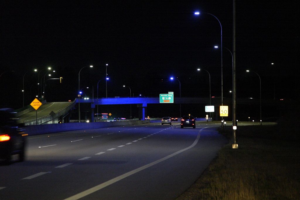

Originally Posted by libtard View Post
Image is not mine, posted by xzmattzx over at https://www.skyscrapercity.com/threads/u...ays-state-highways.605044/post-174275814
This type of set up is everywhere (except the lower mainland).
The overpass in the original post has actually eliminated any type of future expansion by having the support piers right up against the shoulder of the road. Trying to use the space between the retaining wall and the support piers would lead to a bizarre configuration of 2 lanes of traffic going each way and then an extra lane on either side of the support piers? The picture I posted has no support piers so expansion would be seamless by using the space between the shoulder and the retaining wall.
Just hilarious how value engineered this specific overpass is
Almost every single structure on the PMH1 project looks exactly like this, at least on the Surrey and a portion of the Coquitlam sides. Again, different ground conditions allow for different solutions. The Burnaby structures are somewhat different as the ground conditions are much poorer as one approaches Deer Lake. Almost all SFPR structures are also founded on perched abutments, save for a few between 80th and AFB that are on piled abutments (Hidden behind MSE Panel Walls)

This has been a problem down in the United States. Some of the cheaper (there's that magic cost-cutting word again) LED luminaries have been suffering premature phosphor failure that results in a blue or violet light. There is no fix other than the replace the entire light. There's already a whole bunch of them around the new Nordel interchange.
This was in the news recently and I believe it is all being done under warranty as the luminaries have crazy long warranty like 20 years or something
