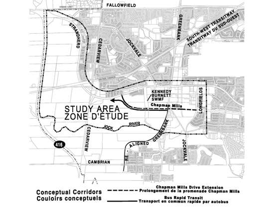

Chapman Mills Extension and Bus Rapid Transit - Environmental Assessment Study
http://ottawa.ca/en/city-hall/public-consultations/transit/open-house-may-7-2015
Notice of Study Commencement and First Open House
Thursday, May 7, 2015
Walter Baker Sports Centre (Barrhaven)
Library Meeting Room (Concourse Level)
100 Malvern Dr, Ottawa, ON K2J 2G5
6:30 to 9 p.m (Presentation: 7 pm)
Transit Access: Route # 170
The City of Ottawa has initiated the Chapman Mills Drive Extension (Longfields Drive to Strandherd Drive) and Bus Rapid Transit (Greenbank Road to west of Cedarview Road) Environmental Assessment (EA) Study to determine the most appropriate means to accommodate and manage increasing transportation infrastructure requirements around the Barrhaven Town Centre area.
Study area - Chapman Mills Drive (Longfields Drive to Strandherd Drive) and Bus Rapid Transit (Greenbank Road to west of Cedarview Road).
This first Open House will provide an overview of study progress to-date including:
The evaluation of alternative corridor alignments
An overview of design alternatives which will be considered in the next phase of the study
