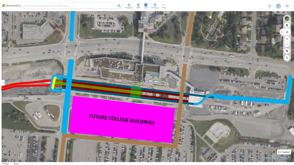

Agreed that the extra space in the Algonquin Tunnel can be used for train storage. That was the plan for when the train was extended south. The benefit is that the new configuration provides storage while Algonquin is a temporary terminus – although the trains might be tricky to get in and out during in-service hours. A better idea would have been to build the tunnel a bit longer, to the south of College Ave., so trains could be stored there, on that tail track. That could have been done with either scheme; and the extra length would have reduced the cost of the next stage.
Over-all, there are benefits to each configuration. In the older planned version, there would have been no train storage until the train was extended; freeing up the side chambers. However, operations should have been smoother and more efficient for the cross buses, since they stay on Navaho. Also, the station would have been closer to Baseline Road to better capture ridership from new buildings and the cluster of building just north of Baseline. Moving the station south actually reduced the catchment area because of more overlap with that of the future Tallwood Station. These two stations will only be about 500m apart. (For reference, Bayview <-> Pimisi ~800; so, about the distance from Navaho to Tallwood.)
Also, the central 2nd-Floor Corridor is maintained across the ACCE and future medical buildings. This passage would be central for each building. The suspected configuration puts the bridges at the ends of the buildings, making for a longer walk.
My recollection of the planned configuration.

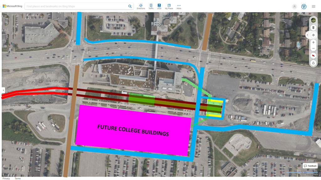

This might be the configuration of what is getting built. I have guessed at which roads will be OC Transpo Only (blue); and I have added an extra north-bound bus lane on Woodroffe.
What I suspect will be built.
Benefits of this configuration are; earlier train storage – which might be important if Stage 3 is delayed; and freeing up property north of Navaho for immediate development.
However, this configuration forces cross buses to travel further and make more turns, which will affect operations.

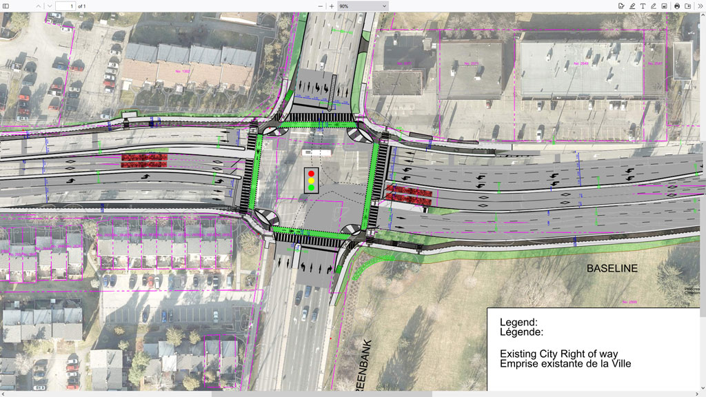

Looking at the Phase 1 plan for the Baseline BRT again. Recall that Phase 1 involves reallocating the existing east-bound third lane between St. John the Apostle Church and Constellation into a Bus-only lane and rebuilding the Baseline-Greenbank intersection.
Here is an image of what is planned for Phase 1 of that intersection:

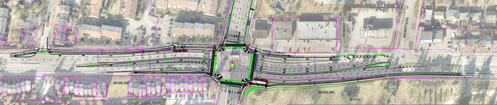

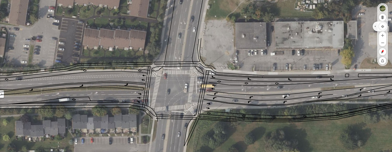

I found it a bit difficult to identify where the extra space was coming from, so I made this rough sketch of the Baseline-Greenbank component of Phase 1:
Looking at that, I wondered if enough property had been taken, or if there would need to be more expropriations and a lot of re-working to do later.
I have not seen the ULTIMATE PLAN for this intersection – the one post-Phase 3, where central bus lanes of the full BRT have been implemented. Therefore, I have had to do a bit of guesswork. Using cut & paste, here is what I imagine the ULTIMATE configuration will look like:
There is room for two general traffic lanes, central bus lanes, bus platforms, cycle tracks, and sidewalks within the new Right of Way (RoW) – but the right-turn lanes along Baseline will need to disappear. The reconfiguration will require a LOT of disruptive construction at the intersection, but, likely no further land purchases.
I find it disappointing that the 800 metres, or so, of Baseline between McWatters and the wider section, east of St. John the Apostle Church, could not be widened at the same time. Obviously, this would have added to the cost of Phase 1, but it would have prevented one of the bottle-necks where buses (and cyclists) need to move from their dedicated lanes into mixed traffic.
Alas, that would have meant actual road construction along Baseline. And we know that, according to City policy, if any reconstruction of a roadway happens, it MUST be reconstructed as a ‘Complete Street’ – inflating the price greatly.
Honestly, I think that the City could have added BUS & BIKE-only lanes – with half-depth bus bays at stops so that bikes could pass without weaving into mixed traffic – within the existing RoW between McWatters and Constellation quite easily, for the most part. It would have provided greater safety for cyclists (over what will be there until Phase 3 is completed) and faster transit – all at a more reasonable price.
But, in Ottawa, if a transit improvement can’t be accomplished with paint alone, then it MUST become a very expensive ‘Complete Street’ project. The Regional Municipality of Ottawa-Carleton (RMOC) believed in relatively inexpensive projects that would benefit transit – but the City of Ottawa does not.

The City has ‘Sharrows’ that tell cyclists and car drivers that they need to share a lane, but when there are professional drivers in buses involved, sharing a lane with bikes simply won’t work. It is better to leave a dedicated bus-lane empty between the every 15-minute or half-hour buses – because there is no way that a bus could ever merge left to go around one of the few cyclists who use Baseline each day.
I wonder if the City realizes that buses will be traveling in the outside lanes, between Greenbank and Centrepointe? And that any cyclists using Baseline in that stretch will also be using the outside lanes? Oh, Good Lord!!!! This is unsafe for people on bikes and will impede transit. And this condition will persist until that huge sack of money drops from the sky to build a ‘Complete Street’ west of Constellation.
I realize that Phase 1 of the Baseline BRT is being done at the lowest possible cost. To do that, there are no physical roadway modifications planned for east of the Greenbank/Baseline intersection. The new bus lanes are going to be paint only; and only where the roadway is already three lanes wide.
However, there is a minimum of about 27.5 metres between the sidewalks on that stretch of Baseline. The distance from McWatters to where the existing three lanes begin is about 800 metres. Given that the current estimated cost to add side bus lanes to about 3 kilometres of Heron Road (between Bank and Conroy) is $122M, I expect that about $45M would add enough width between the existing sidewalks (i.e., no property acquisition needed) from Greenbank to Constellation for the following configuration:
Sidewalk – 1.8m (existing)
Bike and transit lane – 4.5m
General traffic – 3.25m
Median and left-turn lane – 5m
Bike & Transit – 4.5m
Total – 30.6m which will easily fit into the, roughly, 31 metres from outside to outside of the existing sidewalks. Since a standard bus is about 2.6 metres wide, a 4.5-metre-wide lane gives lots of room for both buses and bikes.
Sharrows are not safe.
