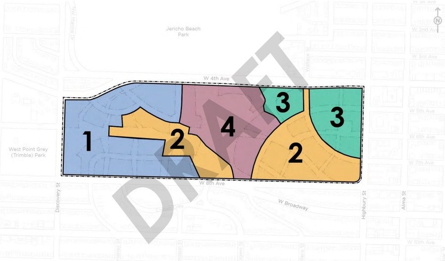

  #456
Old Posted Oct 6, 2024, 10:21 PM
Posts: 15,762
One scenario would use Jericho for the TBM launch. It would be possible to tunnel both east and west from a location that would cause minimal disruption to the neighborhood, as it would still be a vacant and undeveloped piece of land.
I thought they were developing Phase 1 before station construction?
A big factor in the phasing of construction for the Jericho Lands, as a member of the project team previously told STOREYS, is the aforementioned future Jericho Lands Station. Because the station construction involves tunneling through portions of the Jericho Lands site, the builders want to avoid heavy construction above ground that's in close proximity to the station site.
"There are opportunities to deliver on some housing before the transit station is built," the planning team member added. "We think that there is an early phase where we can get some of the public space, some of the commercial retail space, and some of the housing built early."
With the phasing plan detailed in the draft policy statement, this now appears to be how the project will proceed, with the first phase of construction beginning in the western portion of the site, around the area will the future station will be located. (The Jericho Lands Station will be located in the west portion of the second phase.)
The first phase will deliver approximately 4,000,000 sq. ft of residential uses, with a mix of housing tenure and affordability. It will also deliver approximately 400,000 sq. ft of non-residential uses, including a grocery store and a childcare facility, which the project team says "will help establish a walkable, complete community at the outset."
The second phase and beyond will mostly occur after the Jericho Lands Station opens and deliver approximately 4,250,000 sq. ft of residential uses. It will see the construction of the highest densities on the site, including the three "Sentinel" buildings, which will be located near Jericho Lands Station. The second phase will also include 150,000 sq. ft of non-residential uses, including two more childcare facilities, two public plazas, and infrastructure that connects the station to the other parts of the site and Jericho Beach Park.
The City notes, however, that if the delivery of the Jericho Lands Station occurs later than the completion of Phase One, or a decision is made to not go through with the UBC Extension, the City will review the policy statement and the phasing plan as currently outlined could be adjusted.
https://storeys.com/jericho-lands-policy-statement-draft/

I mean, having Phases 2, 3 and 4 gives them plenty of space.
