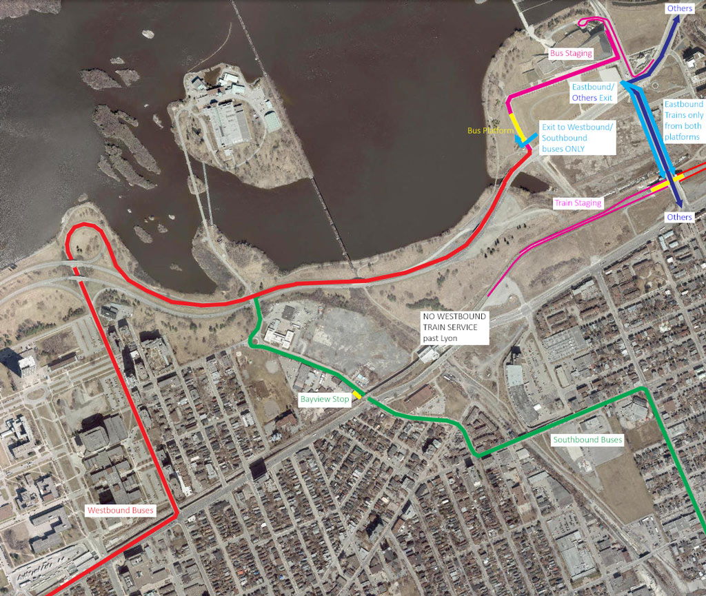

So, if the bridge is the issue, then divide the people BEFORE they cross the bridge. Open up an exit on the west end of the LeBreton site and have buses take people west and south from there. There would be a fence between the bus platform and the firework area.
Eastbound people would use the Booth Street Bridge to get to the Pimisi station, where ONLY EASYBOUND trains would take people from both sides of the platform. (There would be no westbound trains traveling east of Lyon for a short period of time, but there would be a few buses going west/south from Lyon along Albert.)
(Map from GeoOttawa, annotation by me.)
