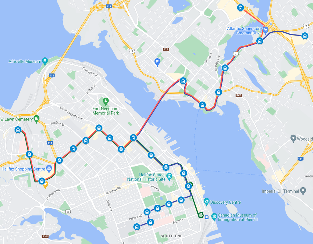

This is the route I envisioned about a year ago which has a tunnel section under Gottingen, Barrington, and SGR. The part that extends into Dartmouth beyond the bridge terminal would be optional and maybe a 2nd phase.
It would feature long sections of dedicated lanes (Bayers, Robie, and Alderney) with both tunneled and elevated sections. It would have sole use of 3rd lane on bridge which alternates directions every 2.5 minutes allowing a blue line and a red line streetcar to cross together every 5 minutes in each direction during peak periods. A vehicle similar to the new TTC streetcars would provide reasonable capacity at this point seeing as they're 50% longer than our current artic buses.
Keep in mind that the overall size of a city has little to do with the specifics of a particular transit route. In other words, you're looking at the wrong thing. The important factors would be the cost vs potential ridership of the different options.
While someone already raised the Edmonton comparison, you can also compare to a larger metro area like Montreal which has about 70km of underground metro for a population of ~4 million which is about 1km for every 57k people. Using that figure Halifax could support about 7km, but we'd only need half that.

Everyone keeps saying a short tunnel. Are we talking half the line would be tunneled, 1/4 of it? Where would this tunnel be exactly??
Where off the peninsula has better terrain for a street car like people on here are asking for?
Not sure about anyone else, but I've been very specific in what I was referring to. My ideal is a tunneled section of about 3.5km, about the same as Edmonton LRT, which isn't short compared to something only a block or two but is very short compared to a fully underground route or system.

What a lot of such debates comes down to for me is that we need to move away from the goal of spending as little we can get away with spending and move toward the goal of building the best city we can afford to build.
I agree. It's not that I'm against a tunnel, but do you think Halifax could afford it? I mean hey, if money was no issue then go for it. There are other alternatives though.
An elevated line along barrington from downtown through the north end would be cheaper, built quicker and run just as good. It could wrap around the peninsula very fast and make connections to other places, spryfield, clayton park, rockingham, bedfor, sackville etc etc. I like the idea of RT bridge over to Dartmouth.
How many of those stations on your map would be underground?

There would be 8, but they'd be very small and simple since it would be for 30m long LRVs. Similar to the Queen Quay streetcar stop if you're familiar with Toronto. Much cheaper than a metro station.

Come to think of it, I suspect the reason Edmonton needed longer trains is that the line has full priority but not full grade separation. The line crosses major multi-lane streets like 112th, 95th and 82nd at grade with crossing boom like a traditional railroad crossing, so if trains were too frequent the crossing boom would basically be down all the time and traffic on these major arterial roads would be blocked. In the Hfx example, outside the tunnel it would be more like St. Clair with full ROW but not full priority. It would be much faster than a bus because of the ROW, wider stop spacing and partial signal priority, but not such complete priority as to snarl road traffic. The high frequency would also add convenience. At peak, it would be every 4 min between downtown and Mumford, 4 min between downtown and Bridge, and 4 min between Mumford and Bridge.
Also, this could be a sort of "pre-metro" where in the distant future the rest of the route could be grade separated to make it a full light metro line. Copenhagen metro has 39m trains on its light metro so while platform lengthening is expensive, this might be a good far future option. Paris and Madrid lengthened platforms on a couple of their lines as well.
