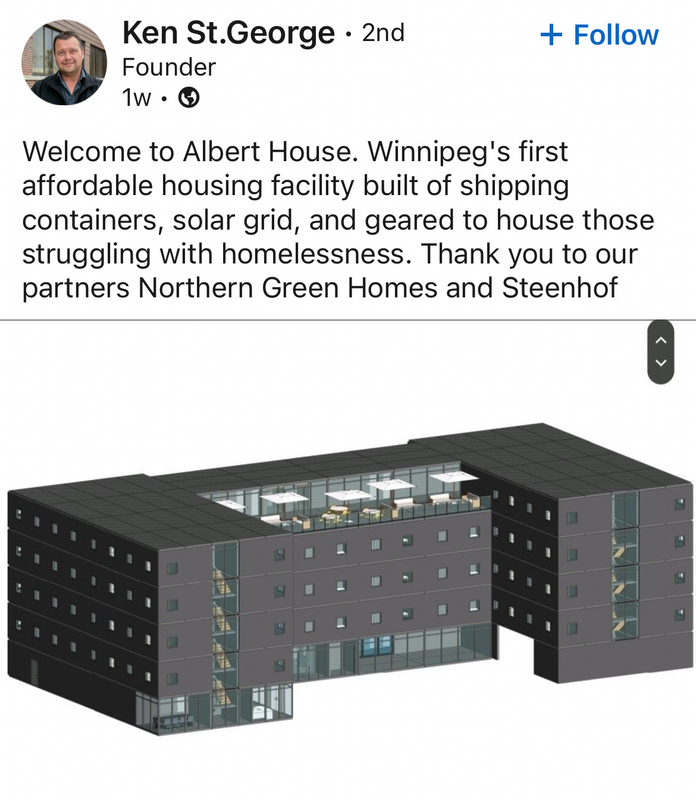

Came across this on LinkedIn.
They will likely learn that shipping containers don’t really work. I personally don’t think we should be putting homeless people in them either. Just build regular housing.
Why don't they work? Have these container home projects failed in other places?

Posts: 1,672
Steel has low thermal conductivity so it would be disastrous in our climate without a major insulation component. Cutting the metal on the shipping container for wiring, windows, doors etc compromises it’s tensile strength a lot which requires it to be reinforced by a different material anyway adding towards the cost. The most important reason is that shipping containers have various health risks because god knows what that shipping container was used for when it was in production.

Shipping containers can certainly be used for fun stuff like this little summertime shopping and entertainment space in Saint John, but it seems questionable as something for year-round habitation in our climate.
I guess it's worth looking into, though.

shipping containers use to be cheap, which provided a "green" solution as they were sitting in railyards / shipyards. Now, there appears to be a shortage of them which has driven up costs.

I don't actually think you are allowed to use used shipping containers for residential. They have to be new, which defeats the purpose.
The interior dimensions are not livable. 7'-10" high and 7'-8" wide before you add strapping and drywall and electrical/mechanical....they are only useful if you don't have to cut them apart, as soon as you do, their structural integrity is lost and you have to start adding reinforcement. Any perceived efficiencies are gone.
Never mind the difficulty of adding insulation and vapour barriers to stacked metal boxes.
It's a stupid idea that was a greenwashing fad ten years ago....its cheaper and easier to just build a wood frame building with proper dimensions and building technologies.

The container housing project is a bit of a mystery to me...I can't imagine that being a good idea from an economic or environmental perspective. Nevertheless, there appears to be a company in Manitoba making houses out of shipping containers.
I'm interested in any attempts at prefab building and reforming the very inefficient construction industry, because we've never seen prefab be a success on a large scale in North America (this is an entire other discussion), but this appears to be a step in the wrong direction.
