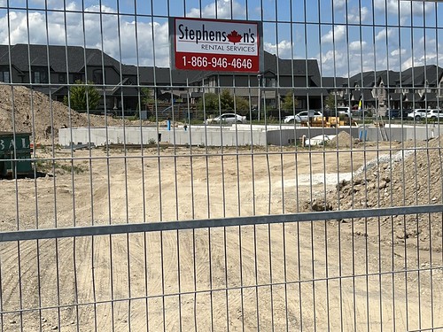

Posts: 6,357
A couple photos of the foundation for one of the new Eve Park buildings. Have to say, the buildings look more impressive on the website than the foundation gives you the impression of lol.
That was my thought as well, I sure hope they are built out like the website shows. This is a very unique concept that needs to be done properly
