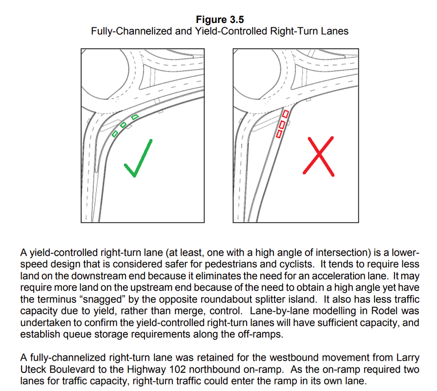

NS DOT messed this up when they choose the wrong roundabout design for the future traffic volume back in 2010.
It also has less traffic capacity due to yield, rather than merge, control
http://conf.tac-atc.ca/english/resourcecentre/readingroom/conference/conf2010/docs/j2/weber.pdf
It looks like they chose the PEDESTRIAN friendly option in 2010, which resulted in dangerous backups occurring on a 100km/h freeway.
The new modification will be the design (green) on the left side of the above diagram +12 years later.
