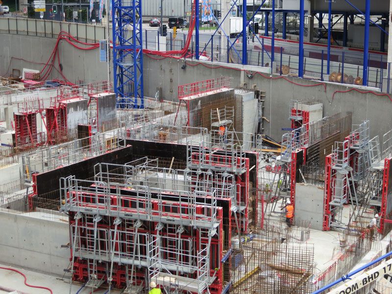

"The 6,500 m³ (literally 1,429,797.2 gal, I guess) foundation raft was carried out to a thickness of 3 m (around 10 ft for sure) in ready-mixed SCC to improve the work conditions, reduce noise pollution and speed up implementation", Rouchette explains. According to him, the rate of that implementation would be of 80 m³ per hour and per pump instead of 25 m³ for a more regular method with vibrators (17,600 gal instead of 5,500). "There was simply no vibrator at all on the site! SCC was used for the raft, for vertical walls of which the thickness goes up to 2 m (~6.5 ft) and for pillars." They had to choose some new options due to the dimensions of the structure, like the implementation of the core with SCC within a self-climbing formwork. And innovations won't stop there: concrete is "traced" (literal translation) in order to make a "connected" building of the tower.

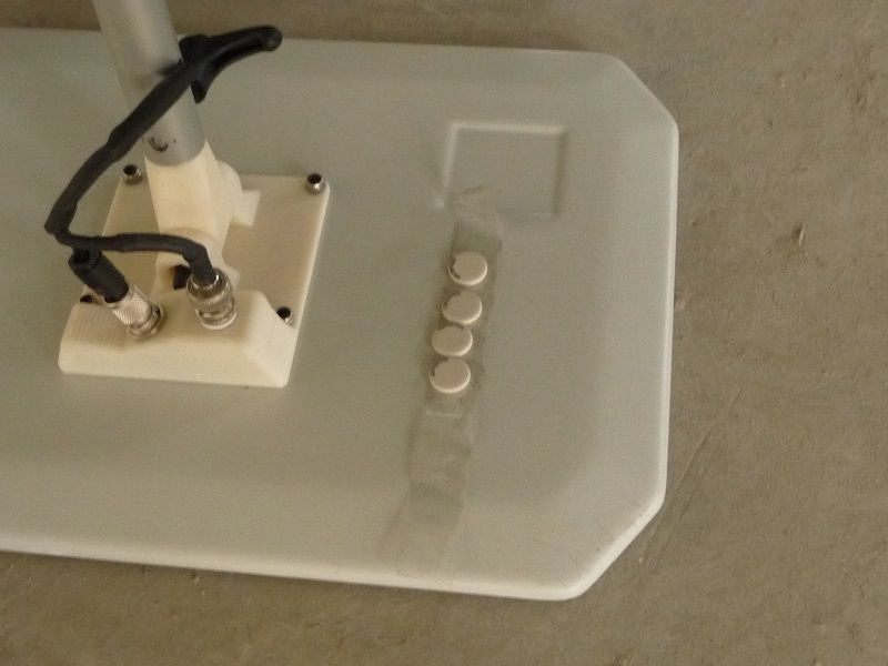

RFID chips as DNA carriers of the structure
Thus, RFID chips were embedded in the concrete mix of Lafarge's plant in Nanterre. A method allowing an undeniable identification of fresh then hardened concrete, within its bulk, to ensure the kind of it, hence its quality and its location in the structure. "Permanent traceability for casted concrete allows to watch the material quality, including standards for environmental certifications, for it is possible to append some metadata", argues Philippe Rouchette. "There are increasing requirements for traceability in construction", adds Pascal Marpeau, the marketing manager of Lafarge's industry department who raises computerization and fast access to data as reasons. Passive chips, of just a centimeter or so (half an inch) in diameter are encapsulated within a plastic shell to resist environmental constraints (pH, temperature, mechanical constraints and so on). A specific reader transmits radio frequency (RF) turning chips on in a short distance (15-20 cm) by supplying them with power. Then in return, it identifies every chip provided with a unique serial number which all needed data match with: delivery number, concrete plant id, concrete trade name, production date and time... Around 2 chips are introduced into the mixer for each cubic meter of concrete, so that the distribution in cast is homogeneous. "The amount of chips is a function of the dimensions of a structure and the number of detections per square meter that a customer wish", Lafarge specifies. As for collecting data, a reader may be set to the chute of a mixer truck to make sure proper concrete is casted on the right spot, whilst a portable reader may be used to collect data from hardened concrete.

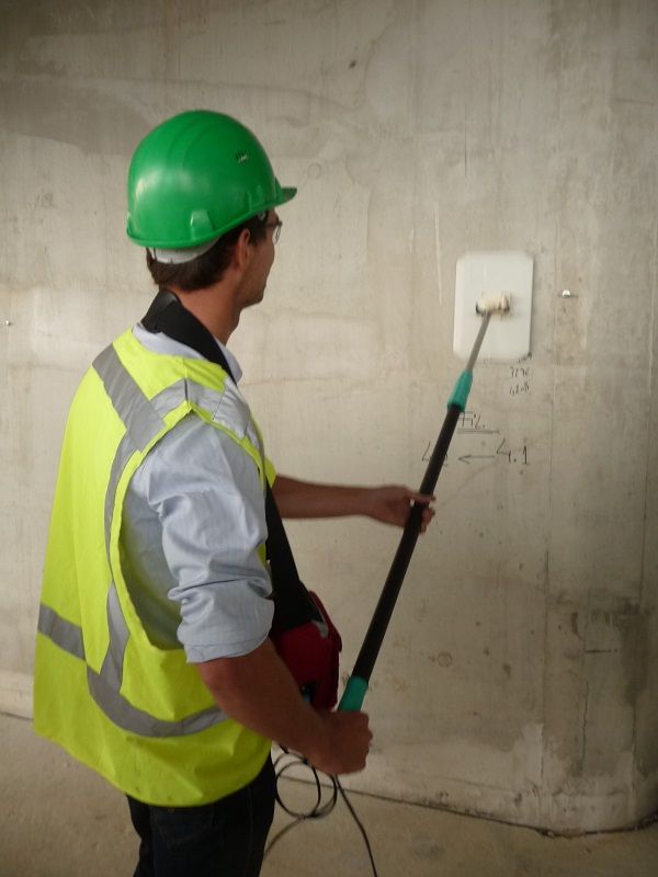

Reading RFID chips
A portable reader lets one scan the ids of RFID chips drowned in the concrete bulk of vertical walls. Once an id collected, it leads to the matching data like origin of concrete, concrete type and traits, date and time of production and so on.
RFID chips
Chips are 1.2 cm in diameter and don't affect the traits of concrete that embed them. Around 4 chips per batch are necessary to ensure reading afterwards. Reinforcement increases interference.

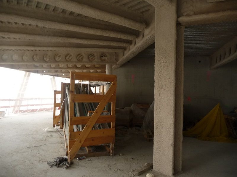

Finally, notice they coated steel joists with something on every floor. Except for the exoskeleton, the entire steel structure is coated in that thing. I know neither why nor what that is. Maybe for local safety standards, but that's only my guess.

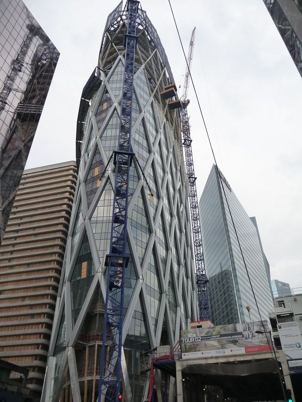

Almost topped out...
Picture by Milo.
