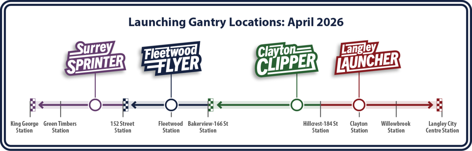

2026, July 19 | Surrey Langley SkyTrain Mega Update | All Stations Construction Progr
The new drone has definitely improved several aspects of filming. I’m now able to capture the entire length of the project. My next investment will be a set of filters, since the sunlight can sometimes be too intense.
Here is the latest progress on the launching gantries:
Surrey Sprinter: At 96 Avenue | 12 spans remaining to reach Green Timbers Station
Fleetwood Flyer: At 156 Street | 26 spans remaining to reach 152 Street Station
Clayton Clipper: Still too early to count the remaining spans…
Langley Launcher: At 64 Avenue | 28 spans remaining to reach Willowbrook Station
I would really appreciate it if you could like and Hype this particular video!

Approximate gantry progress based on odometer measurements taken yesterday evening:
  • Surrey Sprinter: 2.3 km complete, 0.9 km remaining (~72%). Still has Green Timbers Station, pocket track, and Expo Line tie-in.
  • Fleetwood Flyer: 2.5 km complete, 0.9 km remaining (~74%). No more stations ahead.
  • Clayton Clipper: 0.9 km complete, 3.1 km remaining (~23%). Heading into the complex SFMSF connection and pocket track area.
  • Langley Launcher: 2.1 km complete, 2.6 km remaining (~45%). Still needs to pass through Willowbrook Station.
Overall, the four gantries appear to be just over 50% complete by route length.
** All this adds up to 7.8/15.3 km. Google Maps says it's 15.6 km from the end of the Expo Line to 203 street along Fraser Hwy, so there are some minor rounding errors in my measurements.
