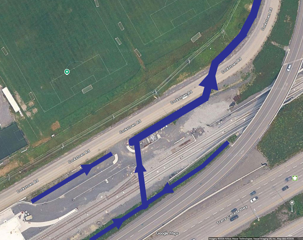

Well, there are still MANY months before the line is to begin testing. I think that there is still plenty of time to get the connection to the Corkstown Yard LMSF fixed. And by ‘FIXED’, I mean also putting in proper drainage in that area. As I mentioned, they need to reinstate a path for water to get to the Stillwater Creek.
Here is my suggestion:
These ditches need to be sized to handle ‘LARGE’ storms – but they will still be inadequate for ‘EXCEPTIONAL’ storms. There is no way to economically prevent problems from exceptional storms.
These ditches direct stormwater into the already existing ditch along the west side of Corkstown Road, that flows to the creek. It might need to be widened.
