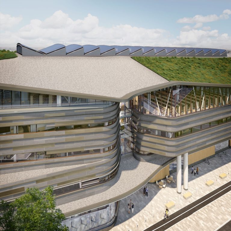

Stone going up fast now. From Dzingle Bells on Skyrise.
https://skyrisecities.com/forum/threads/...y-of-ottawa-diamond-schmitt.30848/page-6
  #1525
Old Posted Jun 12, 2024, 2:08 PM
SL123 SL123 is offline
Join Date: Mar 2021
Posts: 1,966
That looks...Thin.....!! the color though is perfect, its very natural looking and will blend well with the wood accent.
  #1526
Old Posted Jun 12, 2024, 2:44 PM
Posts: 28,961
I was imagining blocks more than veneer. As per the rendering, this will be layered. Should look really good once done.
https://adisoke.ca/news-post/adisoke-spring-update-2023/

The stone detailing looks about the same as the Flaherty building on Elgin. Full blocks of stone haven't been a 'thing' for...30 or 40 years?
The question is, how thin can you go. We keep pushing the limits of what's possible. 8" to 4" to 2" to 1.5" and now...
Does anyone know if this is some sort of laminate system? I see the furring is set at about 1/3 points on the back of the stone sheets, but then how are they clipped onto the building?
I've seen 1.5" panels of limestone pinned in place (the podium level of L'Esplinade Laurier) with varying results, and failures at the pins. How do you pin something to furring? Epoxy? I've also seen epoxied stone fail eventually (embrittlement and eventual debonding).
I like the Flaherty building and the detail there. This one looks like its going in the same direction!
You look at old brick and stone buildings and they seem like solid. They give a sense of permanence. Most stone and brick buildings of today are just a thin veneer. They won't resist to the winds, the rain and the storms over time like those old structures did. Makes you think.
You're right, and I'm not saying the old way is necessarily wrong.
If you look at trends over time, most buildings in Canada today (larger buildings) are stone veneer of some type. Chateau Laurier being a prime example of just a bit thicker stone veneer (6-8"?). Union Station in Toronto is also famously stone veneer. Back then we used cast iron 'cramps' to fasten the stone to the structure. Confederation Building, Supreme Court, Post Office, all of these are just veneer of various thickness over a steel frame.
After that generation of veneer, you have then the National Library, Justice, that type of slightly thinner, 4-6" veneer. Then you get (younger) into different limestone and marble veneers like L'Esplenade Laurier, the Scotiabank on Sparks, those two red granite buildings between Laurier and Slater off Bank. Those are 2" or so of veneer with galvanized or stainless steel pins or butterfly clips.
All of these fail over time with water migration into the cramps, clips or other fasteners and then ghosting (darker areas) and then spalls. You can see the spalls all over the place when you start looking, old, new, thick, thin, they all have the same issues over time.
Crazy failures such as First Canadian Place, (or all the other limestone-marble buildings like Esplanade Laurier or that one in Chicago (all by the same Architect specifying freeze-thaw susceptible marble)
We've learned how to make these super thin panels, laminated, on furring channels that require no exact measurement just clip, clip and slide and you're done. Material cost, embodied CO2, constructability, all these factor into thinner and thinner products. The fact that we rely on peel-and-unstick membranes behind them, to keep water out, is crazy to me, but it's the norm.
The panels on Flaherty are really the first that I've seen in Ottawa of this style, and I haven't really seen all that much weathering or failure. Seems like a good product. Anyone have any other info?
Lecture over. lol

They had no vapor barrier and water proofing at the time. They had the steel structure, followed by thick brick walls, and then the finish, thick stone veneer (like Union) or clean faced full bricks (Ogilvy's, for example).
The old way was probably better to resist to the wears of time, the new way is probably more earthquake proof.
Lecture over. lol
Ha.. just as I was reading these last couple posts I immediately thought of First Canadian Place. I don't think Esplanade Laurier has that kind of money though .

A bit on the Civilization stone.
The building's cladding was selected to complement its architectural goals. Although variegated brick was a trademark of Cardinal, he felt that for a national monument stone was more appropriate; also it can be made to flow better with the curve of a building, lasts longer, and requires less maintenance. Brick was considered as a dressing, to save money, but injection of extra funds allowed the use of a rough-split Tyndall limestone from Manitoba. This buff-coloured fossiliferous stone is durable and easily carved; appropriately, the limestone was itself overridden by glaciers. The embedded fossils provide an element of visual surprise in the sculpture.
https://www.historymuseum.ca/cmc/exhibitions/cmc/architecture/tour15e.html

The stones on top looks thick, but the ones on the bottom look like the same thin veneer.
Really interesting! Thanks for the link.
The veneer stone looks like it has some sort of pre-adhered track system on the back face, made to click into the furring tracks fastened to the structure. Very cool.
