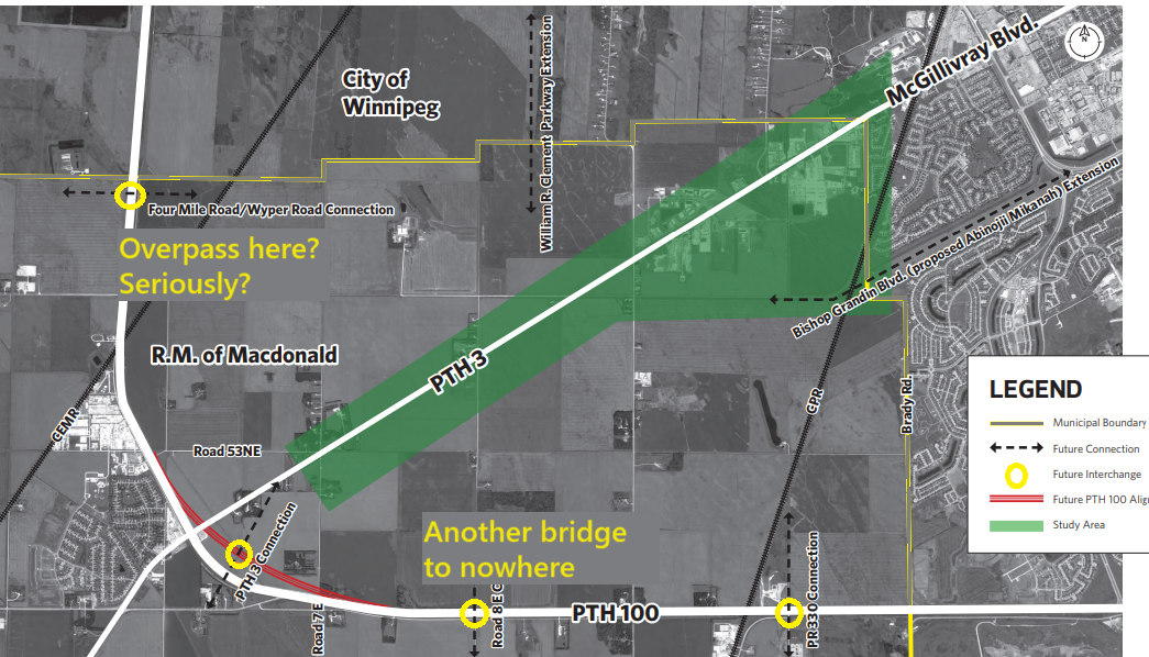

The surveys are out for the Functional Design of the Hwy 3 twinning project (McGillivray).
https://engagemb.ca/pth3
Ahhh yes, let's twin McGillivray so we can add 5 stop lights to it. There's that city planner logic. One proposal 10 lights from Kenaston to Perimeter. lol Gotta get our traffic lights per sqkm up
This is the province, not the city. What choice do they have to increase safety on this stretch of road than to add lights and twin?

  #2328
Old Posted Feb 16, 2024, 6:20 PM
bodaggin bodaggin is offline
Join Date: Sep 2017
Posts: 758
bridges and/or interchanges at every intersection. Bodaggin can give them a sweet price.
I'm not saying overpasses everywhere, I'm saying overpasses where NEEDED. They're proposing 2-3 bridges to nowhere on Perimeter. Why? Wyper road? Seriously? Close the dead intersections and save the cash.
The same logic is happening with traffic lights. They're putting lights everywhere, therefore traffic doesn't flow. These planners don't understand their road hierarchy.
Push frequent intersections to lower and slower local and collector roads, so that higher arterial roads and freeways can have fewer intersection stoppages. Allowing them to flow faster and freer. This is common sense.

  #2331
Old Posted Feb 16, 2024, 8:20 PM
Join Date: Sep 2017
Posts: 758
How about this for McGillivray Twinning. Here's 3 lights, not 6. Why can we come up with better plans in 2hrs than the people we're paying millions for? That's a serious problem.

Guys are you seriously dwelling on Bomberjet's sarcasm?
Everyone agrees McGillivray should be twinned. Bomberjet and everyone else is pointing out that adding 6 lights (like proposed by MB Gov), defeats the entire purpose of twinning.
We're saying, stop adding so many lights. And I proposed a twinning alternative which addressed exactly that.
I totally agree with your design. It should have 2 accesses from service roads, and Bishop Grandin and Will R Clement could have one light. Considering Hwy 3 (future McGillvary blvd) is an arterial road, 5 new stop lights is too many. The more stop lights can be good as it provides more access to the businesses, but still 5 new lights are absurd. That design would be perfect.
