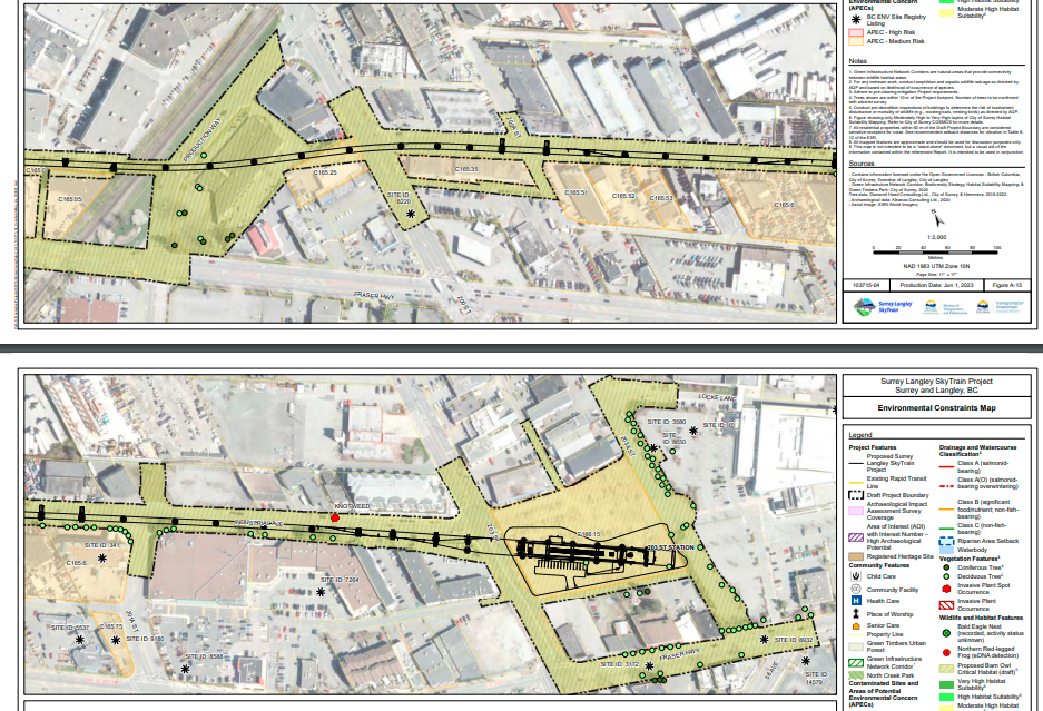

Along with the station names, the BC government released the environmental screening review and construction environmental management plan framework. This framework contains a detailed map of the entire alignment!
Surrey Langley Skytrain resources page: https://www2.gov.bc.ca/gov/content/trans...angley-skytrain-project-resource-library
November 2023 – Construction Environmental Management Plan Framework (see Appendix A): https://www2.gov.bc.ca/assets/gov/transp...ental-2023/231101-sls-cemp-framework.pdf
Observations
- Why are there two sets of switches within 200 m of each other near 203 St? To accomodate a future connection to the new OMC?
- Interesting that they are going with side pocket tracks instead of centre ones. This requires the same number of switches and same number of switch changes as a centre pocket track.
All images below are from the November 2023 – Construction Environmental Management Plan Framework by the BC Government.

Observations
Thanks for posting these, great to finally see the complete route.
BCRTC often parks maintenance vehicles on the tracks over service hours durring major maintenance projects. If they are parked on a centre pocket track the switches become unavailable so they park the maintenance vehicles on one service track beside the centre pocket track with one direction of service slowing down significantly and traveling through the pocket track. Side pocket tracks avoid this issue, the maintenance vehicles can be parked on the pocket track while not blocking the switches between the service tracks and without trains needing to slow for the switches.

Originally Posted by SkytrainCar026 View Post
Observations
At Green Timbers, they seem to have put the side pocket track to avoid the riparian area to the north.
A wider guideway down the middle for a centre pocket may have required longer bents into the riparian area.
It also allows a straighter allignment for the operational tracks.
The switches at 203 are for station movements which they probably want close to the station so a wrong-railing train entering the station doesn't delay an outgoing train, or vice versa.
You're probably right that the ones near 200A are for the OMC access branch.

You see on the either side of the 200A switch, the type of pillar supports a third track to be built in the future, so yes likely it's for OMC access. But not sure why both sides of the switches have those pillar though, unless the OMC location is right beside the track, on the north side of industrial avenue?
Could be for the environmental review, they have included both as options. You'd think that they'd only need one access track.
I could see N-S oriented tracks.

It could be for redundancy. It's the end of the line so those switches will be working continuously; with two sets if one is out of service it does not affect regular service.
