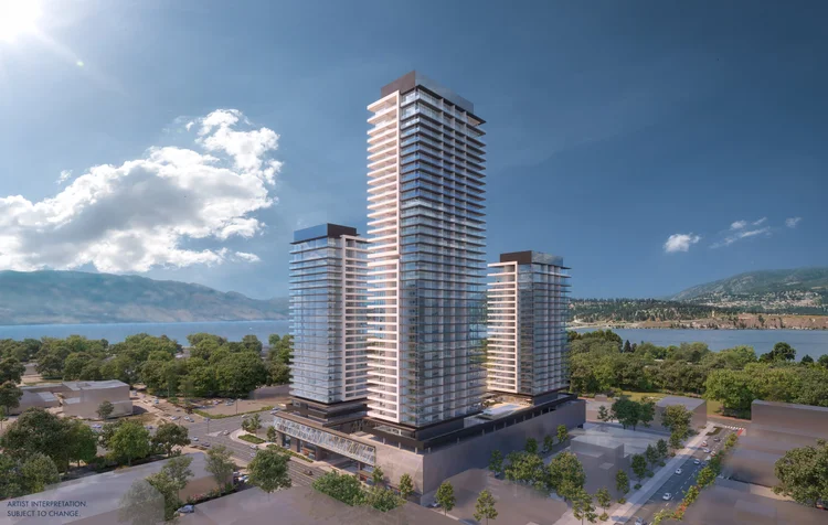

The mid section between the two towers appears to slope down slightly towards the lake, but in the render it is flush across the entire frontage. The question is, was the design slightly revamped and is the second tower closer to the lake going to be slightly lower in elevation than the tower closer to the foreground?
thats a grade change (ramp) for parking inside the building I think. as in Kelowna (like in Squamish) they build most of the parking above ground and only limited below ground.
This is correct. The project had 650 units and 5 levels of parkade to provide adequate parking (1 below grade and 4 above). The paneling in the rendering is put on flush and hides the grade changes of the ramps.
I did forget to provide an update to this podium as changes were needed because of building code issues. As a result, a redesign of the podium materials was needed and redone in an artist style to tribute back to historic chinatown that was once in this area. The material change makes it code compliant and creates bit of an art feature. Below are some elevations. Wish i had some better renderings but these are all i have.

Can someone please tel me, is the shorter building on the right offices? The website says nothing.

Many of you are no doubt already aware of this, but for those who aren't (including me, until just now) apparently underground parking is limited in Kelowna due to the shallow water table:
Kelowna Now: A lack of underground parkades in Kelowna contributes to parking issues
....According to Alan Newcombe, City Infrastructure Director, it is very expensive for developers to building underground parkades because of Okanagan Lake.
“There’s nothing preventing developers from building underground parkades, other than high costs,” explained Newcombe. “It is more difficult to waterproof an underground structure than to build it above ground.”
The height of the lake is an issue for developers as it creates a high groundwater table, particularly in the downtown area. Any structures that are in proximity to the lake face this problem.
“You don’t have to dig down very far before you encounter water. It makes it quite expensive to try and waterproof a permanent structure in the long term underground.”

Offices? All 3 towers are residential.

I was just thinking how this buildings podium actually looks pretty good from previous renders....... Then you go and show me the redesign and I take everything back. What are they thinking!

I can't even...
Redesigns should be for the better. This, while nice for paying tribute to the heritage, seems so lazy and amateurish. They couldn't even be bothered to break it up a bit with different materials. Hell, even the parkade behind Kasugai looks better with a bit different colouring and materials.
Literally looks like stock photography (and who knows, maybe it even is).
Sad to see where development is heading in terms of design.

The shortest tower opposite the two obvious residential towers has an office tower look to it with its glass facade and lack of balconies. But thanks for clarifying for me.

It's a low quality rendering, calm down everybody. TVisforme, Jaymi posted about below grade parking probably within the last 10 pages. Basically, it is entirely possible but cost prohibitive. UBC tower is going four levels of parking below grade at massive expense.
Isn’t one hotel? Or is it rental?
And yeah, I will hold my judgement until I see higher quality images.
As for the parking, we already live in an extreme housing cost crisis, the major costs of underground parking would only be passed into the units, making things even more prohibitively expensive.
The current parking podiums in Kelowna don’t bother me much, they all have at grade commercial and public uses, and the parking structures themselves are largely hidden by decorative elements. In some ways I like it because it gives Kelowna its own unique urban style. I should note that I am a fan of solid street walls in urban settings, so that may make me bias to liking the hulking form of the podiums.

I totally get redesign, especially code compliant alternative solutions, but yes I agree it is a bit disappointing to see the new facade on the building with such a stark differences from the glazing to the mural.
I do wonder what the code issues were that had them remove the original design, it seems like utilizing stand offs could have still allowed for the look of the glazing to cover the massing of the podium walls.

That is the design of the rear of all 3 towers, its just evident on the one tower in the photo posted previously.....

To provide clarification on the original proposal, it was not glazing, it was a Polycarbonates (hard plastic). It likely didn't meet what is allowed for combustible materials for a part 3 building in the code. If it would have looked as good as the rendering being shown i was quite curious about (if it would have been allowed). But like most of you guys, i hope the redesign and installation turns out well compared to the basic elevations i've shown.

I agree that you won't be able to tell till the finished product, but those renderings are brutal and look really amateur. It's a flat wall that stretches an entire block. How hard would it have been to do shadow boxes kinda like Salesforce in Chicago. They could have done the flowers in different sizes, lit up in different colours. These parking garages don't have to be as bad as the developer is building them. They could get more creative than just "Hey here's some Chinese flowers and geo-shapes".
