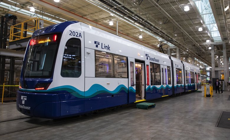

We don't need to switch Ottawa's LRT to high floor. If the real issue is about door layout and use of space there's in fact many diffent model of LRV's that could solve this problem today. We have a problem in Canada of being extremely short sighted when it comes to options and choise of manufacturers (Bombardier vs Alstom).
Siemens for exemple with their S700 or Kinkisharyo-Mitsui LRV's just like the one in Seattle both offer a much more regular door layout for similar performances, with only downside of having small steps at the end of each cars.
We also have the Stadler Tram-Train from Karlsruhe that have long low floor modules, with a more conventional boggie spacing allowing for a better door layout, with then again very similar performances with the ''Plus'' side of being an actual Tram-Train and therefore very similar to Ottawa's Alstom Citadis Spirits.
So in the end, even if I would've liked the city to go for a real light metro rolling stock like the REM, isn't stuck with the options of low floor. And considering the boom in North America of Low Floor LRT network, it wouldn't be a surprise if new manufacturers enter the market with bigger variety of options.
