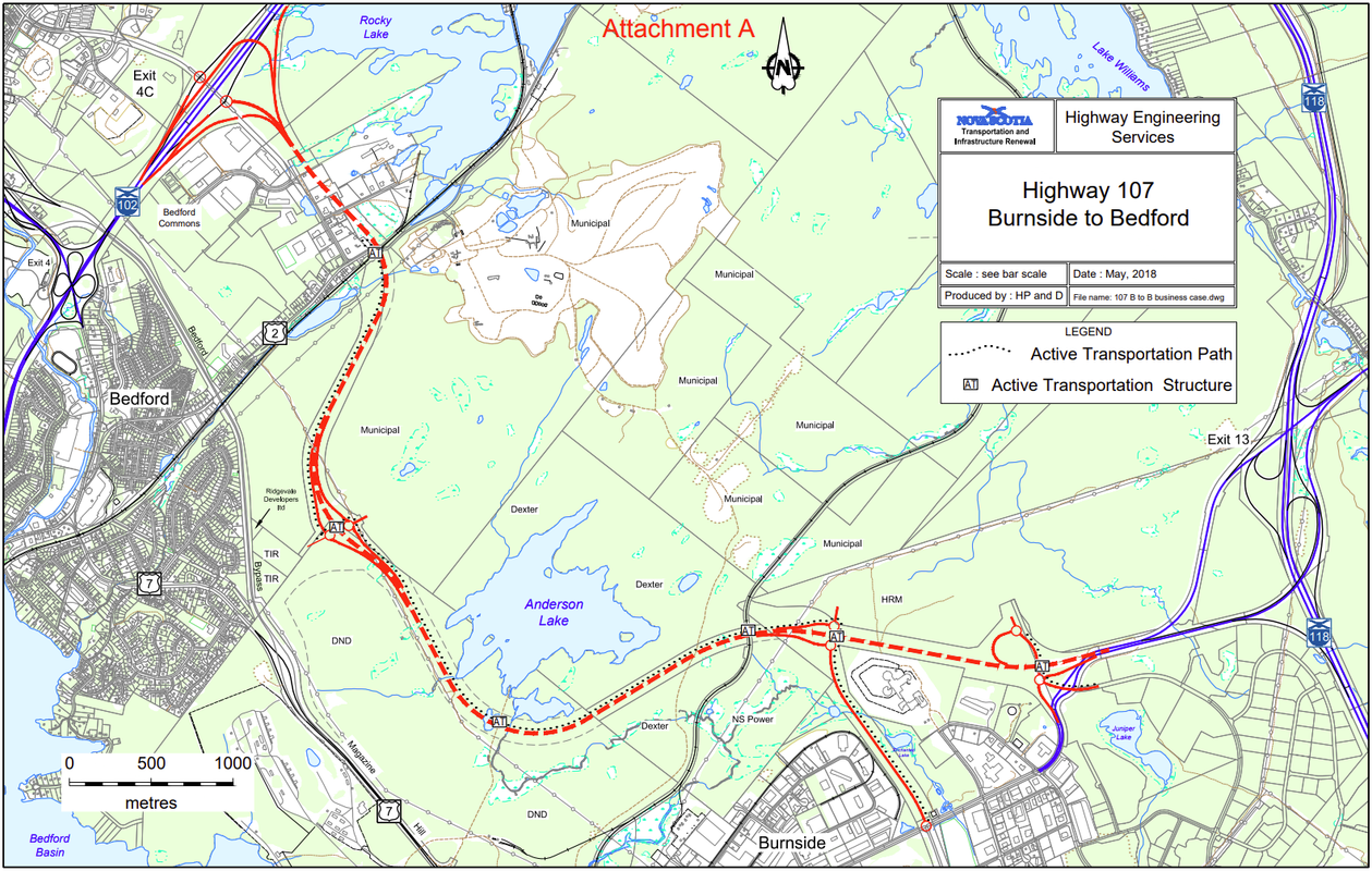

I created a thread for that in Halifax. Wanna repost there?
Anyway, nicely done. Just need to make sure that 101E to 102N isn’t involved in the traffic lights (aka barricaded from them). My thoughts are much closer to yours.
I think the flyover from 102N to 101W is necessary, or else people from Sackville will fume.
Edit: @Franco401 I did it for you.
Now, the question is, will Burnside Connector take traffic off Bedford Bypass?
