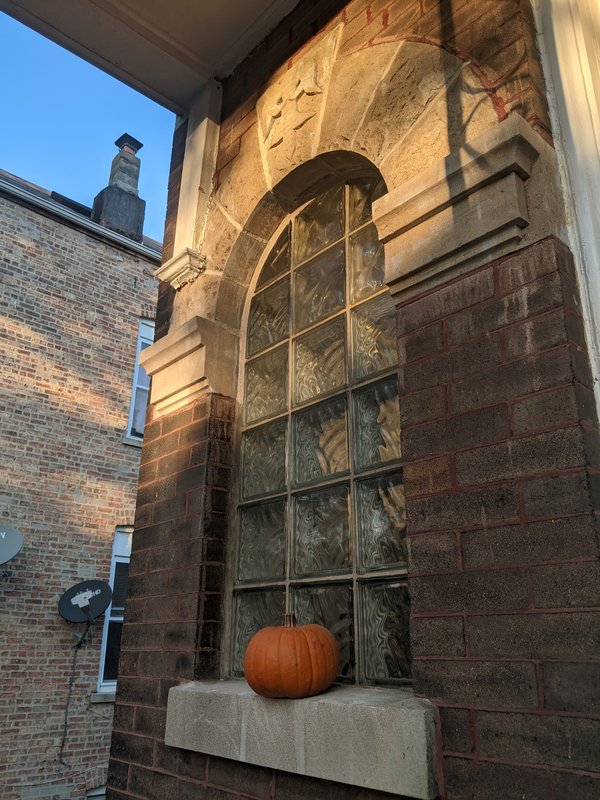

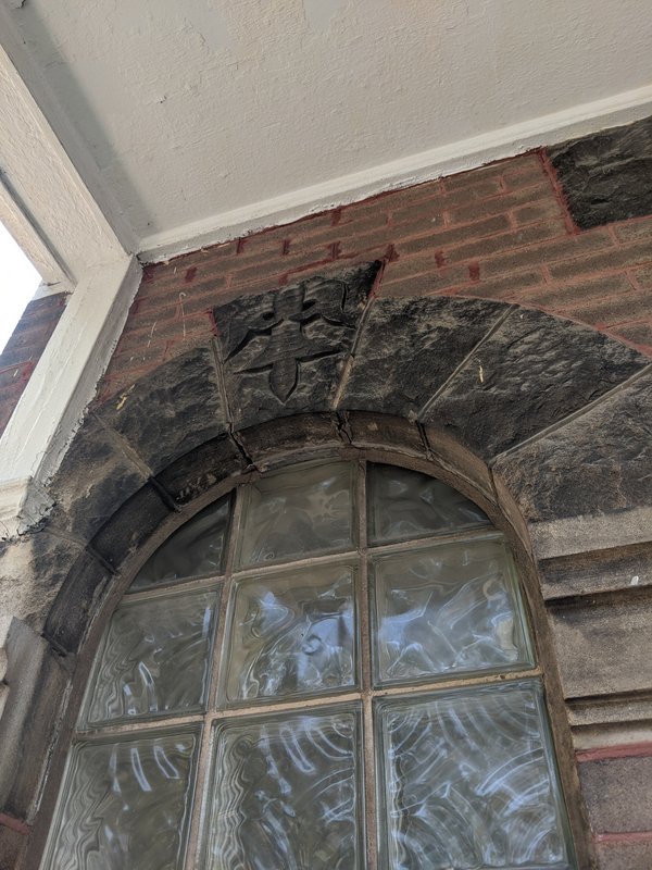

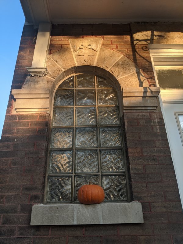

I used Marion Restoration for a little rehab project on our 1903 workers cottage. The limestone decorative elements/lintels above windows were badly soot/weather stained and they did a beautiful and sensitive job bringing them back with the least harsh methods possible. They also used Type O mortar where appropriate, hand chiseled when needed as opposed to relying on grinder, etc.
They were also the only firm we had out who didnt just blindly quote us for work. Theres a crack in our brick garage we wanted addressed but their project manager actually advised us to talk to a structural engineer first, so that the work they did didnt just re-appear. Everyone else just sent some kid out to send photos back to the office and wrote us up a quote for work they didnt even have a good grasp on. I could have easily just blindly walked into one of those bids and not known better. They also steered me away from other "cleanings" to my facade I thought might improve the look, but they advised it would be a bad idea and probably needlessly wash out or damage our finely tooled original mortar in those sections. They'll likely get my work in the future as a result. Its unlikely theyll be the cheapest but it will get done right.
Before
After

Very nice VIA, looks like you've got a particularly fancy cottage on your hands!
Also glad you didn't go with any caustics to clean, that's really only acceptable when trying to get paint off. Usually all you need to do is powerwash the brick on its lowest pressure setting with the widest tip to get 80% of the grime off. The patina of the original brick surface can't be reproduced, unless you wanna wait another 100 years...
And yes, can't tell you how many step fracture repairs I've seen where a new fracture just forms like two feet over because the underlying issues haven't been addressed. That reminds me, I gotta get a mason to address a water infiltration issue I'm having at one of my buildings where old porthole windows were improperly bricked in causing water to collect and enter the wall... Maybe I'll give them a call...

yeah, they advised even against power washing the face brick and ive come around to the patina. they used some sort of non-caustic putty mixture on the limestone (not sure which but guessing it pulled the dirt out of the pores), let that set, and gently washed that off a few different times. definitely one of the only firms Ive found that has a preservation oriented mindset. if there are others out there id love to learn about them.
its definitely satisfying brining those little touches back. theres lots of boring expensive work that needs to be done to homes like this as you know, but anything involving a flourish on the facade is one of those really enjoyable and fun projects to see come to fruition. and it wasnt particularly expensive either in the scheme of things, just a quick day project they squeezed in amongst bigger stuff. one of these days we'll get a nice stained/leaded glass popped back in that opening, but that'll be the cherry on top once we get a lot more important stuff done lol. and theres quite the list.
