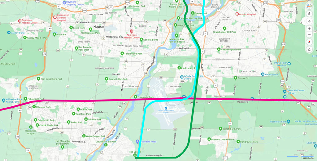

I think that there is a big difference between Ottawa and any other city. To say that it is ‘BEST PRACTICE’ in Europe to do something may not be the case in Ottawa. Absolutely you would not tunnel under the ruins of Rome or Athens – even though huge numbers of tourists want to go there. But just because it is not done there doesn’t mean that the same reasons are valid for Ottawa. It might be BEST PRACTICE to not try to tunnel under Venice, but the reasons for that don’t apply to Ottawa.
Each of the cities that the HSR is going to visit will need to be evaluated with respect to itself. What works best for each city will be done – funds permitting.
Something to remember is that the HSR station will be where people go OCCASIONALLY to begin/end their travel. It is like going to an airport. People will expect to have to travel to/from it – and most will, regardless of where it is located. The location of this station will not be determined with the hope that ‘walk-ins’ will provide the majority of riders. The trick will be to have EXCELLENT public transit from that station to other local destinations throughout the city.
My personal opinions: Downtown or airport.
I think that a downtown station would be great. There is already good transit from downtown to other parts of the city. It could either be in Ottawa (maybe under Albert/Slater) or in Gatineau (between Place du Portage and the Ottawa River with a new pedestrian and transit connection under/over the river to Ottawa). That said, the added cost may not be worth the benefit.
Therefore, an alternative would be to follow Fallowfield Road through the Greenbelt; dive under Prince of Wales Drive; across the Rideau River (on a new bi-level bridge, built for both the HSR, on the lower level, and cars, on the top, to relieve Hunt Club); to an HSR/transit/airport station under the airport; then follow Davidson Road to the east-bound rail corridor. Then put some of the money saved into building better public transit to that station. Build a transit line (basically Line 4 – 2.0) from Limebank Station, north along Limebank Road; turning to travel under the airport (through a tunnel that is parallel to and built at the same time as the HSR tunnel) to stop at an Airport Station; then surface to head north along the rail corridor to the SE Transitway (which would be converted to double-tracked rail to also handle Line 2 – which would remain as it is north of Mooney’s Bay Station); with this line going underground at Billings Bridge to become the Bank Street Subway; which extends under the Ottawa River to a station under Laurier, in the parking lot of Place du Portage. A new, larger interchange station would be needed under the Airport Parkway Bridge for transferring passengers between the Baseline Transitway, Line 2, and Line 4. This station would replace Mooney’s Bay Station and Heron Station (and hopefully be given the name HERON STATION).
In graphic form:
Oh, and Line 2 should be extended across the Rideau River (on another new bridge) to Market Place, as originally planned. And that should be done BEFORE the SW Transitway is torn up to be replaced by the extension of Line 1 to Barrhaven.

Honestly, this is a great idea. Line 2 is a head scratcher in this scenario, because it makes no sense still. But extending Line 4 up Bank Street to downtown terminus is amazing. And an airport connection is amazing. Think also of the parking revenue at the airport for travellers who bring their car there for a little Montreal trip.
In graphic form:

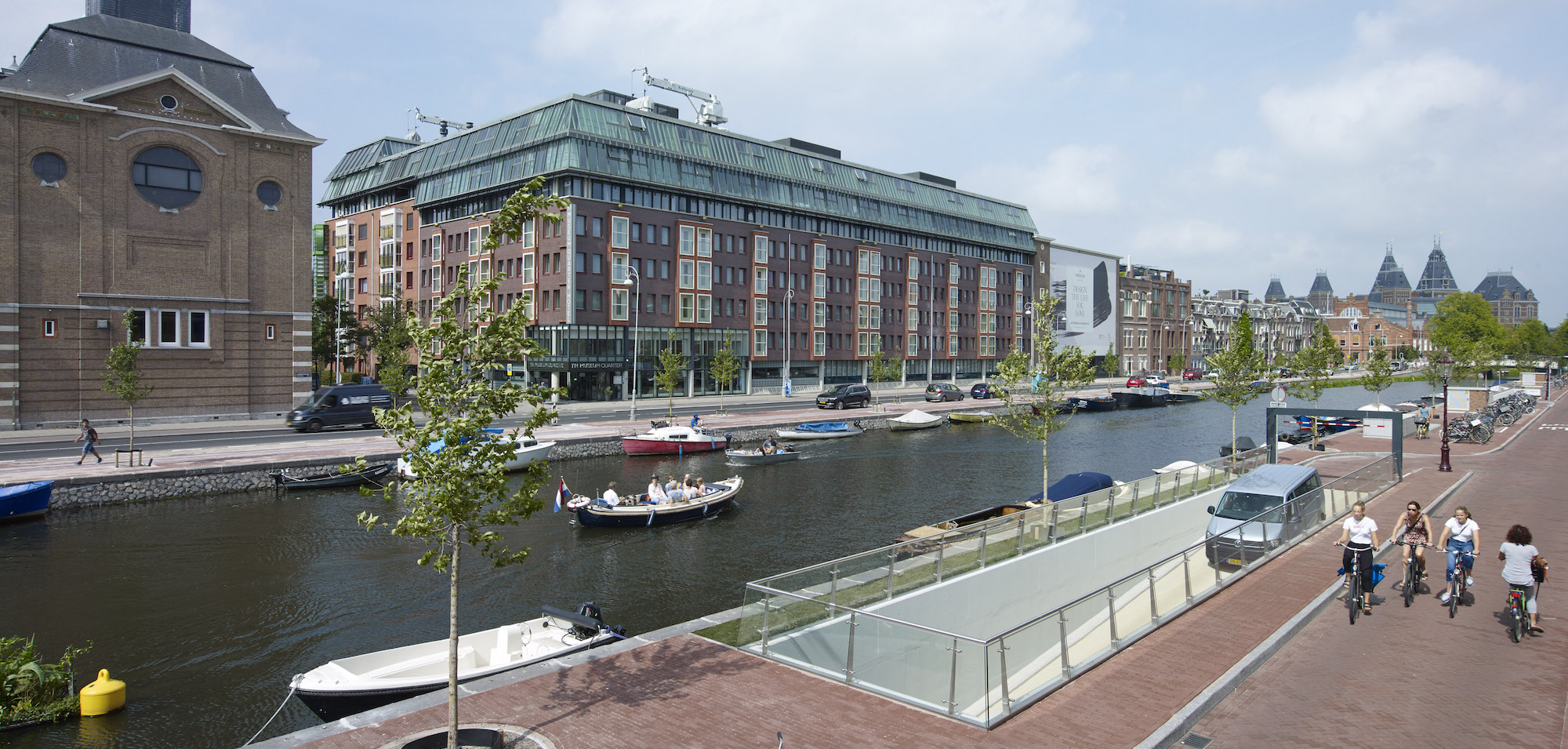

I will preface by saying that I am neither advocating nor not advocating for a downtown station.
I've been thinking about the design viability of Union station's interaction with a tunnelled station. The main issue I've been thinking about is this: if the station is underground, will the old station building be meaningfully connected to the platforms?
If the platforms are bored deep underground, then there's little actual interaction with the station building. Taking a train, you'd enter through the building, but immediately take an elevator or 6 flights of escalators down to where you actually wait for the train. The station building becomes just an oversized elevator waiting room. And the question of the elevators becomes an issue itself, as they'd get easily overwhelmed by a fraction of a train's passenger load arriving all at once (see Édouard-Montpetit REM station's elevator backups, despite much smaller vehicles than a high speed train's).
On the other hand, if the platforms are more directly connected to the station, then passengers can be directed to stairs, and the platforms can be visually and functionally connected to the station building. Flow is smoother and easier.
But this requires a shallow cut-and-cover tunnel - probably no more than two stories (10m) removed. And that's a tough ask in such a constrained space.
But I remembered something from a trip to Amsterdam some years ago: the construction of the Albert Cuyp garage under one of its canals. I remember seeing it opened up, with the water held back on both ends while they built the cut-and-cover box before installing a waterproof membrane and reinstating the canal. The whole thing was surprisingly cheap - 35M EUR back in 2015. Though a station would most certainly be more complex and at least twice the size, I still expected even the simpler garage to be a much more complex and expensive undertaking.
If the downtown Ottawa station were to be selected (again, I'm not wading into that one), a similar construction approach might be a solution that allows for an underground platform and concourse close enough to the station building to make the two meaningfully connected.
Super interesting, thanks. I do think you should stop pushing so hard for Union station though.
Obviously the preferred option would be a station that was more directly connected to the platforms, but I understand that would be a challenge in this context. Without having any idea of the geological or technical challenges under Union, I had kind of pictured platforms that would extend in both directions so that the station roughly sits in the middle. That setup may dictate the construction method.
I was also envisioning other entrances to the platforms, perhaps one in the Market and another near the Rogers Centre or the Rideau Centre parking, so the passenger flow could be shared. The station would be where the services would be located, so it would be more than an elevator waiting room regardless.
